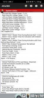

What is this setting in AlfaOBD?:
DRL Fog Light Strategy: NO

That AlfaOBD setting is for the IRCM defrost grid circuit. IRCM (integrated radar camera module) is the DASM, which is the camera on the windshield for adaptive cruise/FCW, and has it’s own little defrost area on the upper windshield in front of where the camera looks out of.

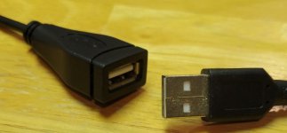

I built one for my brother, with a disconnect so the bus connectors stay and the OBD2 dongle can be removed.
I built myself one but, had a USB male to femaile dongle so, used it. The USB female comes right to the extra hole beside the OBD2 connector.
