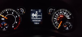

IMG_20211013_202634.jpg Yes!!! I am not sure how to choose which fuel gauge is actually on the mechanical gauge. But right now it shows my second tank on the actual gauge.
