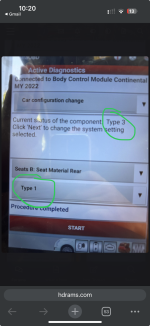

On the first step with Alfa, do you recall if you used Type 1 or Type 3? Both are pictured.
Mine was defaulted to type 1, but changing to type 3 didn’t seem to make any difference.
Ok I went back and looked at my old messages these are the settings I had to change.
Set these settings with alfaobd:
- LIN & Misc: left rear climate seat switch present- YES
- LIN & Misc: right rear climate seat switch present- YES
- Memory: rear heated seats present- YES
- Seats A: rear heated seat levels- 3 LEVEL (high/med/low/off)
- Seats B: seat material rear- TYPE 2
- Cabin Net: CRSM comfort rear seats module- Enabled
