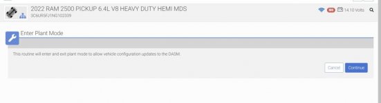

***This is what you need to tell the dealership tech to do if using a used DASM:
1) Perform the “Enter Plant Mode” function:
2) Clear all DTCs. This will get rid of the vehicle configuration mismatch fault so the calibration will run.
3) Run the auto alignment procedure like they normally would:
