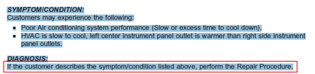

What’s the procedure for checking the vents?
I know we’re looking for consistent temps across the dash vents, but are we looking for a certain temp drop below ambient?
Last summer I felt like my a/c was not as good as I wanted it to be, but I was coming from a king ranch so I didn’t really think too much about it.
Hello there! Please know that our team would be more than willing to assist during your upcoming dealer services in order to have this concern resolved. If additional support is needed, please do not hesitate to send over a private message for further assistance throughout your dealer service.I just got back from lunch and took the truck to check the temps. With the AC set to 68 degrees and the air only at the top, 82 on the passenger side, 110 on the drivers center. Houston we have a problem. I will be contacting the dealer to schedule and order the parts tomorrow.
