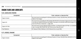

Am I reading that correctly in the manual? Hemi's always needed minimim 91 octane.
Is this correct? Even for towing a 8k lb. RV?

I would agree with you if the manual stated otherwise. In this case it's stating 87 octane. See snapshot right from the manual. My good guess is RAM wouldn't be publishing this for my year/model truck engine if it wasn't good for it. I will definitely see for myself though. RAM can't say jack to me if something goes wrong and that's the main thing. No way they can get out of a potential warranty matter as I went by the book. Just covering my a**.If it's recommended to run 89, you'll get peak performance with that octane. My 5.7 hemi pings quite bad on 87, I run 91 when towing and even then I still get the occasional ping.
You do lose HP with the 87 octane as the truck will pull timing which reduces power. So 89/91 doesn't boost power, it's simply the gas you need to get 100% out of your engine because that's how its tuned, 87 is a reduction from that.
