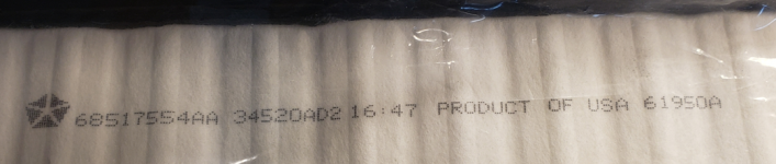

That’s what I use. I haven’t cleaned mine since I originally did it at around 6k miles and now at 33k miles. I was hoping we were over the air filter BS but evidently not. I’m currently running a FleetGuard filter like the one @Units posted that he was having trouble with. I just completed another Active Regen with 25 hours on the EVIC and 990 miles and nothing on the DPF gauge. These trucks shouldn’t be that sensitive as to which quality filter to use. I get trying to run a cheap filter but any good quality filters should be good. I still think it’s one of the sensors not acting right 100% of the time.
