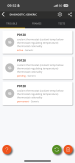

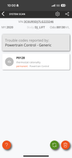

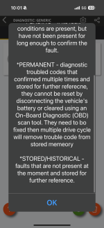

I cleared the P0128 code with JScan however the permanent code did not clear until it went through about 3 drive cycles. It did go away though.
