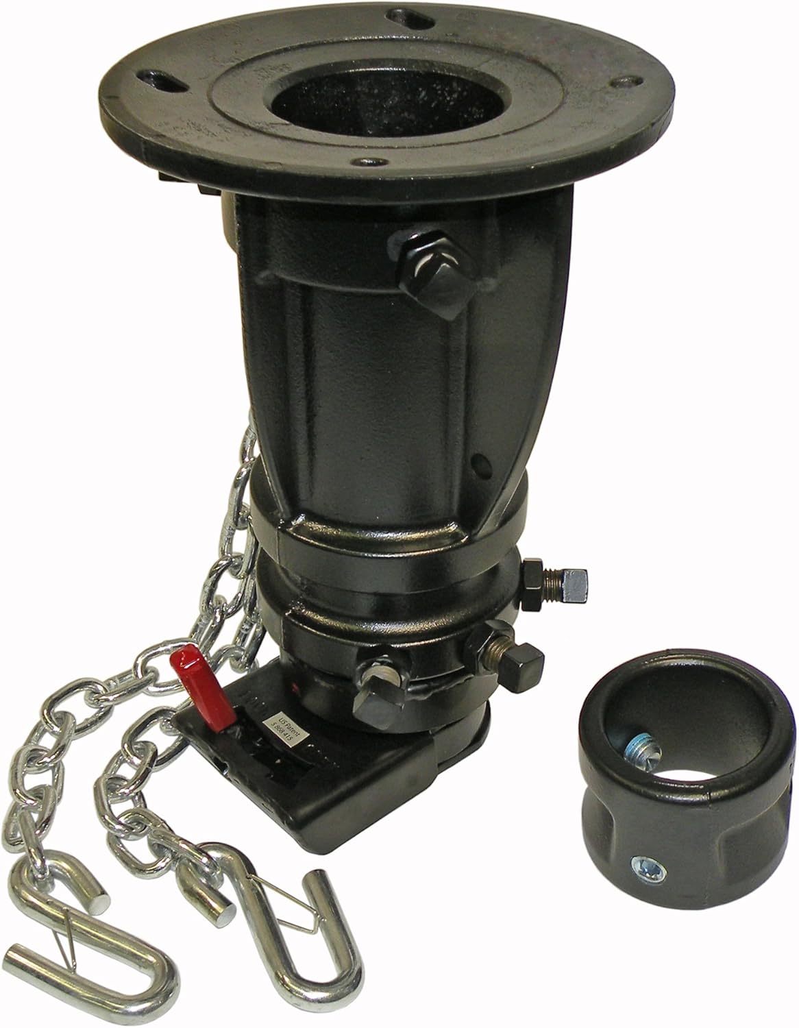

I thought there was a guy on YouTube using an Andersen ultimate hitch and a Reese goose box with his rambox truck.
This would be the way I'd go if I ever decide to go 5ver with my rambox truck. he has a second video on his channel showing clearances at various positions of turning. It looks close but looks like it works.
RE: AUH.
Please don't.
So not having and never having a 5th wheel, what is the problem with this setup? A friend is running this in his 2022 Chevy. He had no reason to have to go this route other than the obvious benefits of the ultimate hitch. The setup was sold to him by the RV dealer where he purchased the RV. I've also seen positive reviews of both products used separately.
I had heard that old school gooseneck adapters were not approved for use on most of the newer campers due to increasing the stress on trailer frame. My dad runs one on an older smaller 5th wheel and it really looks kind of sketchy, but he has had no issues. I thought the goose box was supposed to eliminate those issues. Are you saying that the ultimate hitch is the problem in this setup?The most prone to failure hitch on the market.
The GN adapter version, not rail system, is also known to damage bees because it’s not a rigid connection.
