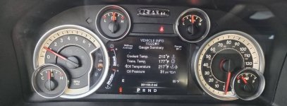

Looking at a truck to buy. 31psi oil pressure. Seems low to me. Or is it fine for 2014 truck?
It's the computer that controls that value. At least I think that is the case for 2014. My old 2003 did that according to Chrysler "to meet customer expectations". If you believe the computer then at idle that is not bad considering your temps. Your coolant temps seem somewhat high.
