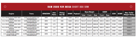

I know this might be an older post but wanted to chime in a bit.
I have a 2019 Megacab BigHorn with close to 2040 payload (The sticker states this) with air ride and the safety group. Want to let you know the ride for daily driving is miles above my 2017 f250, so its not just an bigger advance of an older f250 but even a newer gen F250. Just make sure to remove the PSI after the dealer gives you the truck, as mine was like 90 psi when its supposed to be like 60. Its due to shipping on why the psi is so high at first. Also, there is 3 options for air ride system. Normal height (daily drive), Alt Height (What you use when towing, goes down an inch and half I believe) and lowering bed mode (Used to hook up a trailer and have to be done using the controls on the screen instead of the button).

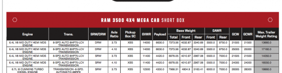

To respond about you going over payload, I had to do some research with parts, comparing to 3500. Figured I would share this.
I am going to register this truck at 11500-12k GVWR and already in the works in doing so (Yes you can do this and yes its simply a legality reason). I know many have opinions of 2500 vs 3500 and I am not trying to really get into it but just explaining what I am doing and researched.
I matched this current axle 11.5 AAM to previous 3500 before the 2019 (10k gross on the axle, same with front for 2500 2019). The parts actually match (Brakes, axles, pins, etc), so your there is room to improve .Of course the only difference was the springs in the rear (Leaf versus coil, or air bags, which is actually the weakest link), The front end of my 2019 is the same as a 3500 now, as well as the spring since I have a megacab. 5500 FAWR (Crew cab) vs 6000 FAWR (Mega cab)
Brakes also match between the 2500 and 3500 even in the current year. From what I have found, there is no difference in braking power between the model years (Also since both models have exhaust brake for the cummins, no difference there). Which means 2500 and 3500 can stop the same . I believe if you want bigger brakes you have to opt for the Max towing option on the 3500 and that typically goes towards a dually, not SRW. And tires and rims were never really an issue as they are always in the ball park of 7k-7500 per axle weight rating and are the same on a 3500.
I know many just tow without doing any increase of GVWR registration, I truly do not blame them when places in Nevada you pay a hefty premium for registration. I just wanted to inform you that you will most likely no where be near your RAWR and FAWR and have better distribution between the front and rear when towing with the rear air suspension with your trailer. So when people say "Shoulda got a 3500", its just silly if you do not tow very often. Hope this information helps!

Okay, so I weighed my truck with a load of wood
GVWR is 10000. Front GAWR is 5500 rear is 6000. Payload sticker reads 2998. Giving a base weight of 7002.
Since this whole payload and towing deal is so full of opinions, I figured I would share the numbers.
Used the CAT scale and the CAT app. Awesome tools.
So truck weighed 9860 which gives 140 lbs left til GVWR is hit.
Newest theory is to not exceed GAWR...so at 6000 I was 800lbs under at 5200. So there isn't too much extra capacity as some have been claiming. And the front axle was at 4660 which leaves 840lbs.
So, with GAWR adding up to 11500 I should have 1640 total pounds I can add, but only 800 in the bed and I would think adding extra interior cargo would also bump into the rear and front GAWR.
Truck still had a bit of rake...so I feel certain the other 800lbs would have taken it away and then some.
With this i feel the 10000 GVWR can be exceeded...but it is a legit number and something else is the limiter.
The truck loved hauling the load though, got that HEMI right were it wanted to be.

Just to clarify, I have a 6k FAWR and 6040 RAWR. which is 12040 but I agree with you in saying 12k is definitely pushing it.. I do believe the air ride will push more weight to equal out thru the truck itself, as not all weight attributes to the rear axle. But I am curious, do you have air ride or just coils on your 2500?
Just what I have discovered is the axle, tires, rims and frame are not a limiting factor of the GAWR, its the suspension and sometimes braking.
However, the 2500 and 3500 are identical with braking parts so that isn't a limiting factor here either. But you are very correct, you cannot exceed your RAWR, even with you not exceeding your FAWR you cannot add more weight. I am not sure if you can shift weight or if air ride will essentially do that for you but in theory it should help with that balancing act, at least I would think.
I will update once I do the register but after looking at all of the components of the truck and matching part numbers from 2018 3500 gen (Just the axle as they used 11.5 AAM that year, 10k gross rating) to the 2019 3500 gen (Frame, Braking, tires, rims). It's identical except for the 5 link suspension and 12 AAM axle ( 10500 I believe, might be more but that doesn't really come into play here).
Which is why I concluded that is the suspension weakest link, so if you are able to upgrade your suspension than wouldn't you essentially be able to match the same numbers as a 3500 payload? As the RAWR on a 3500 is 7000k but has a 2200 more payload than a 2500. This is a big question for me, since only 1k in the RAWR is higher than 2500, where is that additional 1k payload coming from to total to 2200 pounds. But I believe this is how you know its based on class, not capability as the GVWR on a 3500 Megacab is 12300 with a GAWR of 13k.
Also, If the 2500 GVWR was only 700 pounds away from its GAWR like the 3500, it would be 11340. But its actually 2040 pounds less than its GAWR of 12040. If there is a truly limiting factor (Which I cannot find comparing parts) than I would definitely like to know.

Also I am seeing Laramie 2500s with the cummins with over 2000lbs payload, which isn't as good as the ~3000 the gas gets, but certainly useable if your trailer isn't too light. The only thing holding back the cummins is going to be how it competes against the new Duramax / Powerstroke diesel combos in efficiency.
