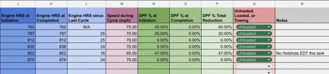

I’ll add my own experiences from my truck (2022 HO) that I’ve been tracking. It would definitely seem mine is on the 24-25 hour track, aside from when the soot load triggered an active regen faster than the timer. Once completed, mine appears to definitely reset the regeneration timer after each sequence based solely on the data I see. I’m not using any sort of aftermarket monitoring, just the OEM gauge on the evic and the cues I hear from the truck while driving. I will note that I wasn’t previously using hotshots EDT prior to starting this spreadsheet and my soot loading seemed to accumulate faster and passive regeneration didn’t seem to be as frequent or as effective. My truck sees the same routine drive cycles which is a mix of city and highway, with mostly unloaded operating. I took two screen shots of the spreadsheet to make it easier to read, as the whole sheet is wide.
These instances referenced in this thread where there has been a significant amount of time, well in excess of the 24 hour time interval, between regen cycles is concerning. I have operated under the understanding that these systems were designed to actively regenerate every 24 hours as a “fail safe” to ensure the system was routinely “burned out”, especially in situations where the drive cycles alone will not generate the temperatures and length of time necessary to see effective passive regeneration. I wouldn’t imagine why they would want to change the emission control strategy in that manner. To me, the policy of either / or (timer or soot load) gives the best overall protection of the emissions system for a wide range of operational situations. It’ll be interesting to see where this all leads. There have been numerous posts both here and elsewhere regarding DPF ‘s filling prematurely recently. This is especially true of 2022 model year trucks.
Just today I also verified what I’ve heard about any active regen resetting the 24 hour timer.
My last 24 hour regen was at 293 hours. I then had a DPF soot loading regen at 306 hours. I hit 318 hours today, 25 hours since my last time based regen, and the CTS3 shows I’m only 51% of the way to my next regen.
I spend some time bouncing around 40-45% with some around town drives, but a 90 minute tow down the interstate, and back, out the percentage back at time based.
