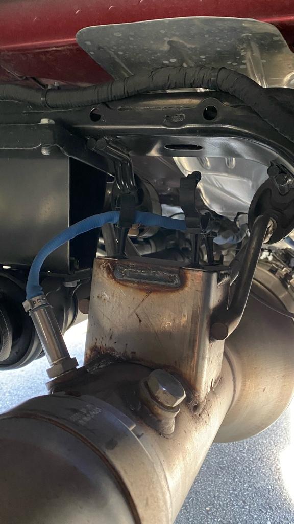

Finally had a free minute to crawl under mine. Same here, definitely missing.
Obviously it is why else would they tell you its missing…Finally had a free minute to crawl under mine. Same here, definitely missing.![]()
So apparently Ram has a recall out to install the missing particulate matter sensor in the 2022 cab and chassis trucks. Y43 campaign started 12/6/2022 according to the Ram recall site.
