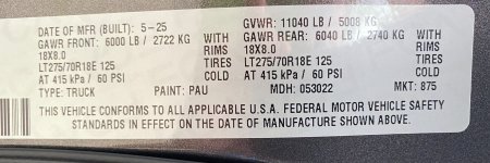

2025 2500 with 11,040 GVWR/over 3k diesel payload?!
That's what I am waiting for as well......
Just to throw in the mix for anyone with 2500 Rebels with the Cummins... I know Rebels are known for the low payload and towing compared to the other trims due to suspension, etc... but I wanted to have the best of both worlds to have the locking differential and slightly higher lift for off roading. I only trailer about 10,000 lbs max so figured the Rebel was a good choice to have more towing capacity than a 1500.
I am seeing a lot of "older" build 2500 Cummins Rebels i.e. February - March builds that have the 10,000 GVRW which equals to about 1,700 - 1,900 lbs of payload.
HOWEVER, magically Cummins Rebel builds after 04-25 now have 11,000 lb GVRW which shows payload sticker at 2,775 lbs
What did they do differently to achieve this?!
It sucks as my truck was built on 03-31-25 according to my tracker and is just arriving to my dealer, so first thing I'm going to do is look at my sticker...............
Any thoughts from anyone what the difference could be? different springs? or just the same truck with a new sticker?

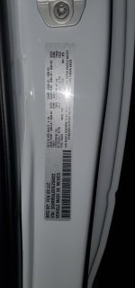

That's interesting. Here are the stickers on my 2023 gasser. I specifically bought the gasser for the higher payload on the 2500.
