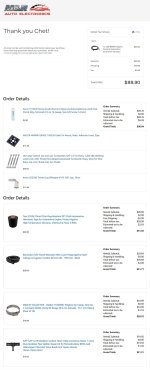

Here, I continue documenting expenses for historical reference.
