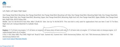

That attachment does not indicate this is for a 6.4 hemi in the 2500s.
Then which 6.4l "heavy duty" Hemi do you suppose this refers to?
