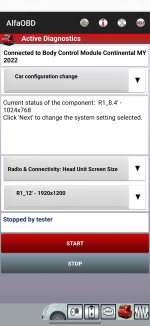

anyone have issues with traction control button not working? Im 2022 ram 2500 8.4 non nav uconnect 5-12 uconnect 5... attached is what I changed to see if it works but no go @Jimmy07
anyone having issues with traction control not working enable cabin Net: DCSD DISPLAY SCREEN MODULE ENABLED SOLVED MY ISSUES
