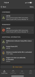

Unfortunately I had the same issue today (25 with 1,400 miles). Froze on that start screen. I was in a rush so drove it anyhow. Mechanically drove fine but had no blinkers, speedometer, blind spot warning, etc.
After sitting off for 15 mins, it was normal at the next start. I now have a check engine. Diagnostic below…

I have a banks idash but it doesn’t see any of these codes that you posted. Maybe the dealer will see them when it goes in.
Do you have a check engine light on? I may have triggered it because I drove a few miles in that state.
