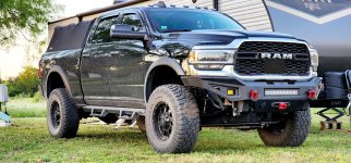

First post here! I recently purchased a 2019 SRW 3500 H.O. Cummins Crew Cab Long Bed. I am doing 285/75/R18 Rodge Grapplers or similar, with Method NV305 HDs, Air Lift 5000's rear and a Thuren Level w/ track bad and Bilstein 5100's! I'm having a hard time deciding on the 1.75" or the 2.25" kit. Anyone had any input on which to go with? Pictures of both trucks attached!
Any pictures of your trucks would be great as well!

2.25” really goes just past level.
285s fit really good stock
2.25” on 285s is a lot
37s fill it out
