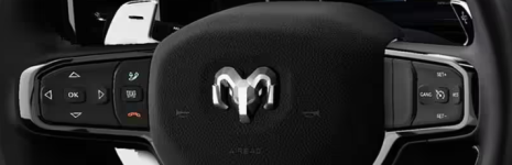

Greetings,
So mine has the 12" already, with NAV. Also i think i have what you are describing on the left hand side. The steering looks like this...
so probably just cluster, and adapter harness? What would i need the AlfaOBD for? I only ask because mine has the half digital cluster in it, so it must know how to move around in a digital enviroment already.

That’s strange that the non digital cluster equipped left wheel switch has the pages button on yours. This is a 2023 Laramie with the non digital:
But, if yours has it, that’s one less thing you need.

Greetings,
I took a stock photo, not sure exactly on mine, saw a laramie and just took a pick cause it looked close to. Might need that switch too.
Will head out in a minute and check. Think your picture is more correct with mine.

Greetings,

Yeah, the one you posted is a rendering of a 1500 wheel…that only has the left paddle shifter.
LOL, that will teach me to just grab a pic off the internet.....
