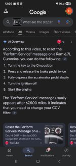

I figured it out myself.. maybe that guy used the fob but i was able to use the ignition button. To on.. step on the brake twice, slowly put the accelerator to thr floor and there you have it. Now time to scan and see What's going on. Thanks for the reply.

That procedure for re-setting the service indicator shouldn’t have any impact on the truck starting or not.
Seems odd.
