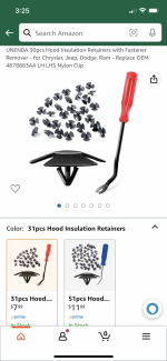

The windshield washer lines are fastened to the hood underside. You have to take the hood liner loose or down to get access. As Darkone said, the liner fasteners are a pain to remove. I tried several fastener removers, the only one that worked was this type of Fastener removal tool

I ordered some that looked exactly like what you've pictured. I returned them as they were too small for the hood's holes. Sorry, I've looked but can't find what I ended up ordering.
I had better luck than you did with the Amazon parts. They’re slightly different in texture but they’re exactly right in size and function.
FYI, as stated above, I would consider the clips to be “one time use”. the clips I reused were not holding the liner snugly at all. The new clips are much more secure.
