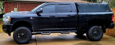

I have them front and rear. My front windows have done that to me a few times when the truck has been outside in the really cold. Normally they work just fine. The front vents were a piece of cake to install. The rears took a bit longer with some provided 3M tape and a couple clips. I would recommend them. This is the best picture of them I could find.

It's been a while but if I recall the Weathertech installed between the window frame and the channel so it pinches the channel a bit. Not an issue when its warm but the rubber is less flexible when its cold and the window doesn't like it. I can force it closed by not using express up, just bumping the switch until it seats.
