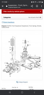

I believe the 4500-5500's are still using the 4 link short arm suspension like what is found on the '12 and older trucks, that would be the main hurdle in swapping axles
I thought they changed that when they went to the CAD axle in 19?
I'm blown away that they are still using early 4th gen suspension on the 4500+ trucks. Keep wondering where that Ram 4500 pickup is, but guess it's stuck back in 2010.
