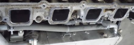

Pictures of the truck 6.4 heads

The 392 and 6.4 BGE intake ports layouts are identical. You can swap intakes between the two engines.
So, while Whipple does not make a "kit" for the 6.4 BGE, they do for the 392. You would have to do your own research in to tuning. There are tons of people out there with Whipple'd 6.4 BGE's. It's actually the preferred platform for boost.
