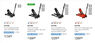

Just to help out whoever can answer this question, I looked up the ranges of these jacks:
The one for $174 has a range of 5" to 18 1/4"
The $184 is 3" to 20"
The $239 (on sale for $209) is 3 1/4" to 24 1/4"
The $289 is 3 3/4" to 23 1/8"
If they have a removable jacking pad you can have an extention post machined so the lift height will be greater
Ok, so what is the consensus then on the height that we need? Wil any of the ones listed above work? Or 20" just to be safe?
The ones you listed with an extention would be fine just remember almost every lifting point is 8” minimum off the ground most of them are closer to 12” so you will only get 6-8 inches of lift with any jacks you listed the.
