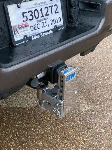

Tucks under real nice and comes in black too. But I have chrome. No more busted knee caps with this one.
Tow N Stow here, too. B&W stuff always works well, and is made in Kansas, not Shanghai.
