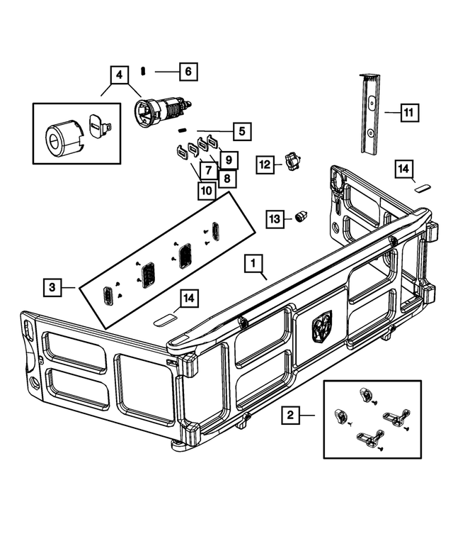

I traded my 2019 RAM Classic in for a 2022 Ram Rebel. I have the bed divider but just found out (from this site) that I can't use it as an extender. I don't have the hardware (grommets & Handles) for it. Will the parts listed below work for a "new" body as opposed to the Classic?
For the bottom two holes - 68054997AB (Grommet, pivot joint)
For the top two holes - 68054996AA (Handle, swivel release)
Can someone please explain the difference in the 2 part numbers? 68054996AA & 68054997AB. When I search the same image appears. Thanks
Look at the picture (or read the post right above yours), 1 is part 12 (the swivel release handle) and 1 is part 13 (the fixed grommet). You need 2 of each.
Sorry for the ignorance! Every time I googled the part numbers, it returned pictures of all 4 pieces (2 x part 12 & 2 x part 13). Clearly, the pictures returned were of the whole kit. Thank you for clearing this up!
