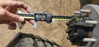

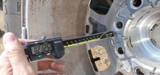

I searched both the forum and Google without much luck. I will be leveling my new 2020 CTD and going to 35s, but I love the laramie longhorn wheels coming on my truck. I've seen a number of people run similar setups and all have 2" spacers. Mathematically, a 1.5" spacer would be a better choice because that would be a +15 and closer to the +18 sweet spot that CJC refers to vs the +2 with a 2" spacer.
My question is does anyone know if I can run a 1.5" without cutting the wheel studs or are they shorter than 1.5"?

Also keep in mind that offset is meaningless without also including wheel width. An 8" wide wheel with a +18 offset will look and got completely different than a 9" wheel with a +18 offset. The 8" would have a backspace of 5.2", and 4.8" of wheel outboard of the mounting surface. The 9" wheel would have a backspace of 5.7" and 5.3" of wheel outboard of the mounting surface. That's going to change both clearances for the wheel/tire in the wheel well, and how far the wheel/tire stick out of the wheel well.
As far as the cutting the studs, most wheels have pockets on the backside between the lug holes. If your studs are proud of the spacer, they usually will go into that dead space in the wheel mounting surface, so you don't have to cut them.

I would also try it first without the wheel spacers. My 19 laramie barely rubbed at full lock reverse with 35 12.5 Cooper ST Maxx. I just dealt with it. I have made several posts about spacers here with not much luck. Ultimately, you'll need 2" spacers. Anything less will require you to trim your wheel studs. I ended up buying new wheels with a +12 offset for my 20 tradesman because quality spacers were going to be pricey.

I'm going with Nitto Recon Grappler A/T 35" tires on my stock 20" Night Edition wheels. Will have tires tomorrow. Not jumping the gun here but getting prepared if my 2" Thuren Leveling kit doesn't help in allowing the tires to clear the radius arms. It appears some people barely rub at full lock and most do definitely on stock suspension setups and even caught a YouTube video of a guy with a 2" leveled truck and still hit radius arms with the Nittos. Bora recommends you have at least 7 thread turns on the oem lug when using their hub eccentric plate style spacer only (no lug threads on spacer) and of course using OEM studs. My question is if 1/4 inch spacer would be enough or if play safe and go with 3/8 spacer will I still be able to have enough threads on the studs for proper safe and secure wheel torque?
