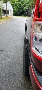

This. Scroll through the pics on this page until you see the Ram. The back wheel looks like it is pretty far out. I think most guys go with +18 to +57, but don’t quote me on that :)

That -18 though:eek: I ran a +18 and stone chips galore. Those wheels will poke out darn near an additional 1-1/2”. Also depending on your state regs, you may be ticketed.

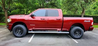

I found a 2500 with a -18 offset -
Love the look but damn, you're right. Look at all the **** on the door.
