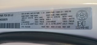

Still don't quite get it, what would you recommend based on my tires?
how much is your payload on the other sticker? from that you can get a close estimate of how much your truck weighs ie 11800 ie the gvwr minus payload.
so say your truck weighs 7900lbs full of gas etc and you and your passenger at say 400lb that would be 8300lbs. say your front axle was carrying 60% of your weight ie 4980lbs and your rear 40% ie 3320lb you could safely get away with running 50psi up front and 35psi in back. that is all hypothetical tho on your real weight and weight bias. without weighing it is just a guess.
