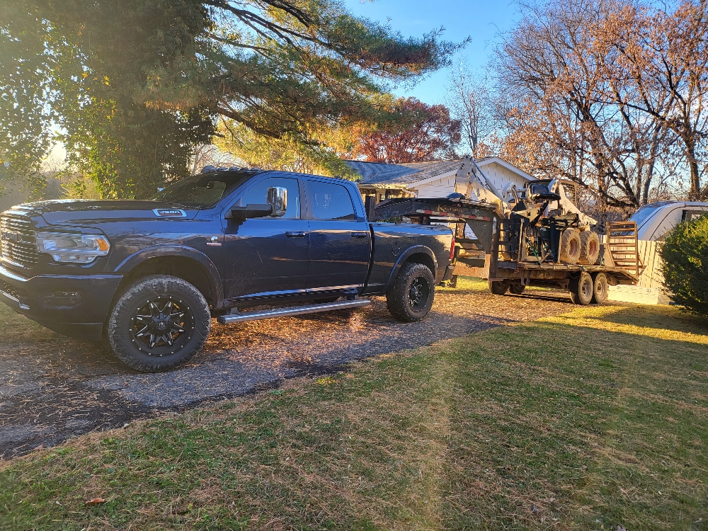

Looks like any old pin box you will need a slider hitch for sharp turns…. Finding one for the Ram box may prove difficult
Put in some work
