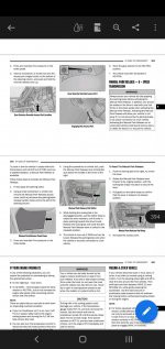

I pulled the panel below the light switch and have not seen anything like this. it is some kind of pull strap but not sure what it does. what ever it controls is obviously spring loaded. Anyone know what it is and what the function is. I know it is not a MIL ejection seat strap as it is behind the panel never get to it in time while driving :)

you have the Aisin tranny it sounds like the 8speed ZF tranny has it.
If you can't start the vehicle you can't get it out of Park. So you have to use the emergency rip cord to do it.

Its for the 8 speed only its to be able to put it on a towtruck if you cant get it out of park
The cummins you can still pop the shifter off and get in gear
