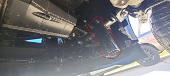

Crawled under my truck earlier to remove my front air dam - I see the 4,000 10mm fasteners, clips, 2 brackets, etc to remove - doesn't look difficult at all. However, I noticed these low hanging brackets off the frame that will hang lower than the bumper after I remove the air dam.
If I had to guess, I would assume they are for an intercooler if the truck was a cummins. They do not appear to be attached to anything, just bolted through the frame.
As above, You “can“ remove them. Should you remove them? Well they were put there for a reason, if you were involved in an accident and the other car submarined because the brackets were removed,
and someone in the other car passed or was injured you would be burdened with the guilt for the rest of your life. They don’t hurt anything (except my head when I banged it against it changing my oil filter once), so might as well just leave them in place. Plus they act as a bit of protection for the winch when off-roading.
@Darkone hit the nail on the head here. Up to you if you want to remove them. They are a safety feature for other smaller vehicles, not for you. Take that as you will.
One interesting tidbit to note, they aren't on the 3500 because it's over the weight cap the NHTSA put for these things, so it's only the 2500 that has them (or should be anyway).

One other thing to consider as part of this conversation. These brackets are supposed to be low enough so that they interact with the frame portion of smaller vehicles. the NHTSA calls these "SEAS" (Secondary Energy Absorbing Structure), and they are included when a truck is too tall and thus not enough of it's PEAS (Primary Energy Absorbing Structure) overlaps with that of other passenger cars. Here are some interesting docs with pics and renders that may be interesting to anyone interested in the topic (doc 1, doc 2).
The thing to consider, if your vehicle lifted? These brackets are only what 6-9" tall? Are you running larger tires? All in all, for most guys running a basic 2" level, plus 35s, you're talking about almost 3" being removed from that bar, and keep in mind that the bottom part of the bar is most likely receiving the most contact due to how tall these trucks already are. If you're jumping up to a Thuren tall coil, a Carli kit, or AEV, you're talking about 3" up front plus 37s, so roughly 2" from stock. So now we are up to 5" taller than stock, which removes most of the brackets contact surface, and the most important area. Guys with 6" and up lifts, absolutely no reason for them to be there.
Now, assuming they don't bother you from a looks perspective, and you're not lifted tall enough to make them completely worthless, no real harm in keeping them. My point here is that as you change your truck, you're also changing how these were designed by the OEM, and they start to work less or not at all. If you really care about other drivers, maybe you should have some longer ones made? ;)

I just sent mine out in the mail to some dude with a 3500 so he could mount a CJC guard. Looking at them there is no way past a 5mph crash they are going to do anything to effect the outcome of a collision with a smaller vehicle. They would snap right off. You would really need a under run bar like on a semi trailer to prevent riding up on a rice rocket.
