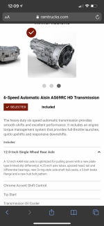

I could be mistaken but I thought I read the SO has a 11.5” AAM. Trying to see where I read that...
Yep, based on what I see on Ram’s build, I’m fairly certain the 12” AAM is reserved for HO configurations (not sure on DRW)
