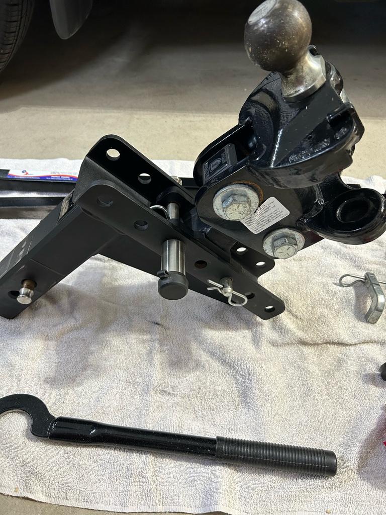

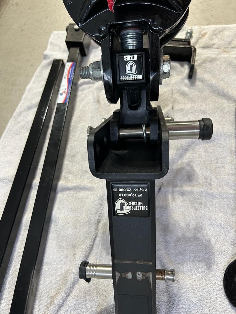

I have a 2022 3500 Mega cab SRW with Ram's factory air suspension
I use the bullet proof hitch at the moment. We just purchased a 36ft travel trailer. On the tow home I noticed a little bit of sway. This was going over a bridge, rough asphalt, and irregular traffic lane.
The trailer is 7700lbs dry and have has 900lb hitch weight also dry. Should I move to get a weight distribution with anti sway? Could I just add the bulletproof anti sway system? The truck and trailer are level after the factory air ride adjusts.
Recommendations for a WDH that either works with the bullet proof hitches or fits the 2.5" reciever

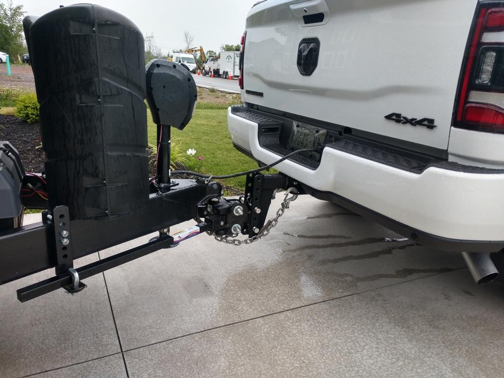

I was using a Bulletproof setup combined with Fastway E2 WD on our TT. Worked great. The bars are 1k tongue weight and 10k trailer weight. Bulletproof sells a WD adapter for their hitch setup if you find a system you like. Or you can buy mine! Going 5er and no longer need it.
An added bonus and the main reason I went with that whole setup was I could open my tailgate completely with the TT connected. No more jack interference.

I too use the Equalizer brand with my 35' bumper pull, and it is rock solid stable, even in high winds
