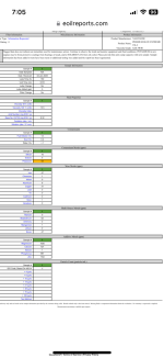

Here are the results of the second oil sample taken from my 2024 Ram 2500 6.7 Cummins. I posted the first UOA with factory fill a few months ago. This is the second oil change, and the oil (VPBE 5W40) had 6,310 miles and 180 hours on it. I did the first oil change at 3k miles. I’m curious if the elevated potassium is related to flux or if there’s something coolant-related going on. Sodium looks fine, which would sway me slightly from the coolant theory. There is an odd ticking sound coming from the EGR cooler/turbo area, and the truck is going to the dealer Monday for this; I posted the video here.
