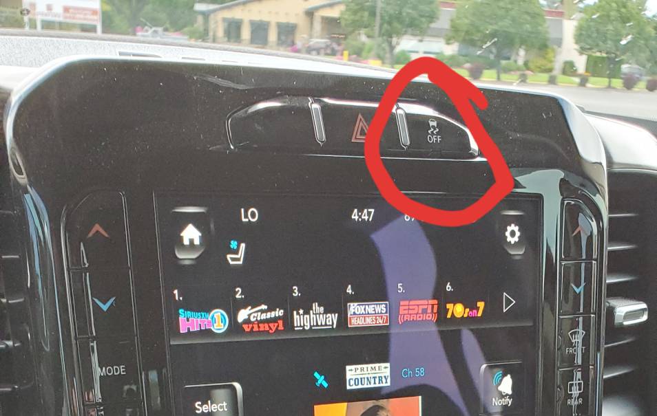

Can anyone tell me how to turn off the ESC on a 2019 RAM 3500 with the 6.7 HO / Aisin?
Push the ESC off button circled in the picture. This is a "partial off" mode. The owners manual talks about starting on page 200.

Thanks for the help.
On the previous gen you could completely turn off each by placing in 4x4 and then pressing and holding the esc. That completely turns it off
