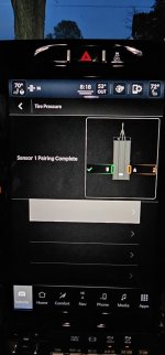

I followed all the instructions on the other post about adding TTPMS to my 2022 Ram 2500 Laramie and used alfaobd to enable the two settings. The screens all seem to show up. The truck allows me to start the sensor pairing process. Works similar to how it says and then tells me finished. Once I select finish, the screen acts as if I did nothing. The dash shows not configured and the screen is at the screen to set up the trailer tires. I have done this multiple times with same ending. Also tried driving down the road after selecting finch and nothing. This is being done on a single axle trailer with a 4 pin trailer light connection. Is that my problem?

I have. It is immediately after selecting finish it goes to the screen to set up the sensors showing nothing was done.

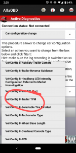

Did you do this last step?

I did but I'll have to double check it I guess. I believe that was the first one I did. I enabled two things through alfaobd.
I had to go back and do that one, but I did it before I tried to pair up the sensors...

Both are enabled. I also can not get the system id log to upload to my Google drive and just getting errors that there is no logs or unreadable.
So my truck randomly did an OTA update 2 days ago, later that day both trailers synced and worked first go around. Woke up this morning and the truck now says it's not configured. So I did learn that you do not need the 7 way plug for the trailer tire pressure monitoring system to work. My non-electric brake, 4 pin trailer light, trailer did connect and did work for a drive down the road. Unfortunately this one and the other seem to have lost the connection.

I did get mine working on my '22 2500 by resetting the settings in alfaobd. What I found I have to do occasionally is switch to a different trailer for a few min then go back to trailer I want and it will then come up. Also the tire pressure set limit keeps resetting to 50psi for me no matter how many times I change it, I've come to just accept that and stopped trying to get it to stay.
