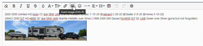

My bad. I checked again. You have to use the Insert Image in the Signature editor and it only accepts a URL (image link).
So you'll have to put the image on a web host somewhere (I prefer imgur for random stuff) so I don't have to share links to my OneDrive or google drive.
You could also use the link to one of your pics posted here... Let me know if you still need help and we can do a quick webex or teamviewer and get you dialed in.
