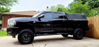

Anybody got this on their 3500? Good or bad?
I was looking at their 1" block for my 2500 to go with the new 35s I have sitting in the shop. I prefer to keep some rake for the towing squat. My research says that the springs on the newer Rams will bow out when spacer lifts are added. On my Jeeps and other trucks I've always gone with springs and this one probably will end up the same. Fortunately one of the new wheels I ordered got damaged so I'll have a few weeks to save for the Thuren springs.
Ya I was worried bout it bowing too. I might jus go with some springs. Anybody hot bilstein springs? I'm in Canada so bilstein is much easier to get than carli or thuren
I helped a close friend install the bilstein 2.3" level kit and it's a REALLY nice package.
yup rough country adjustable bar.
I run the r.c. bars front and back, but I'm running 3" spacer front and 2.5" spacer in back so I needed them. not necessary on the bilstein kit.
Did your coils bow any? I have a spacer coming in mail ( 1.5 inch)
What's the ride height of ur truck and ur friends truck after lift to sharkfin?
I'll have to measure this wknd. I do need to measure mine to make sure I can get in the parking garage at work, if we ever get back to that point.
Nice. I have the stock Bilsteins and don't know what to get. I want to keep my stock Bilsteins but level it. Looking at maybe the Readylift 1.75 spacer. Do they all need shock extensions, or only over a certain height?
I heard anything under 2 inch u should be good but I dont think it would hurt to have extensions
