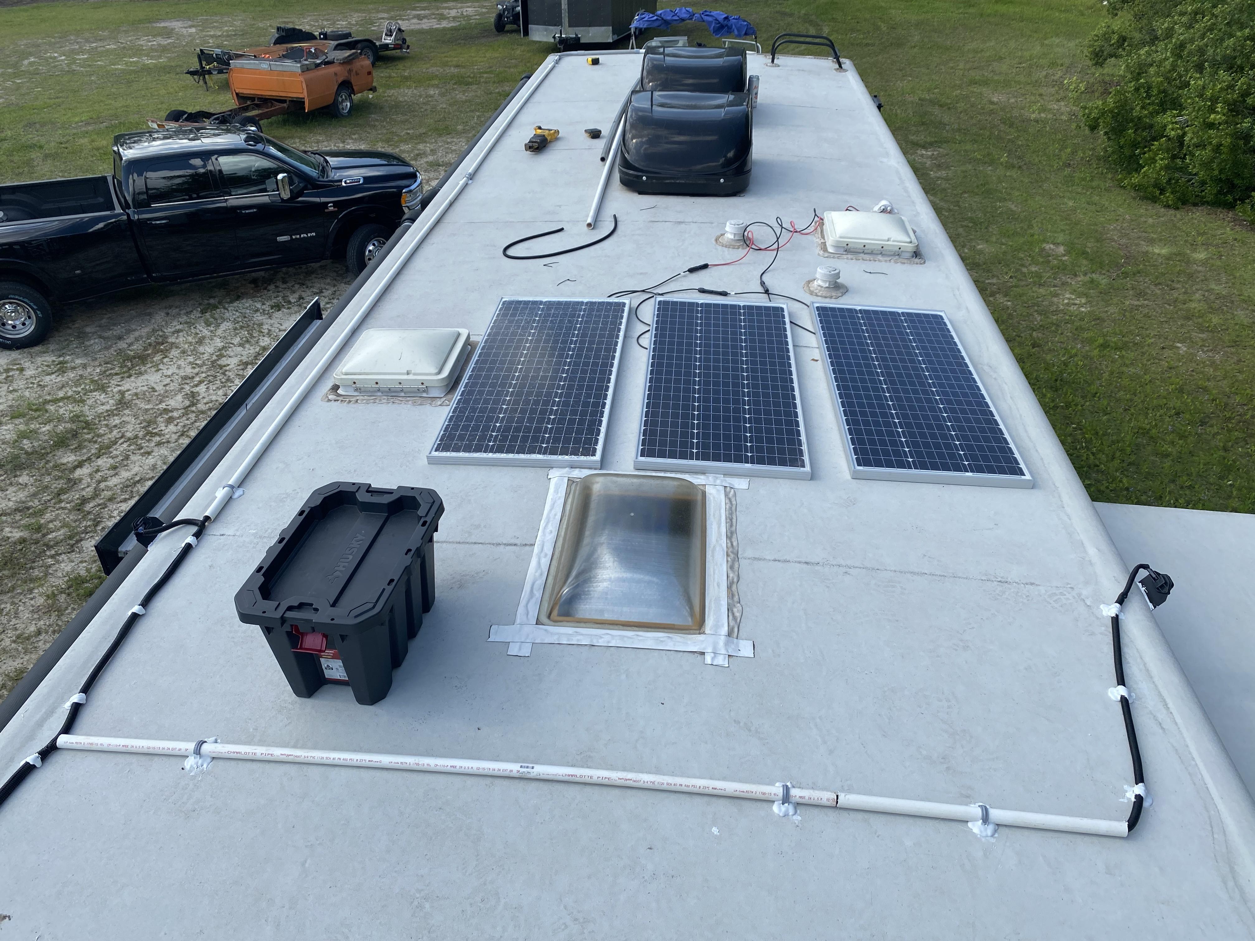

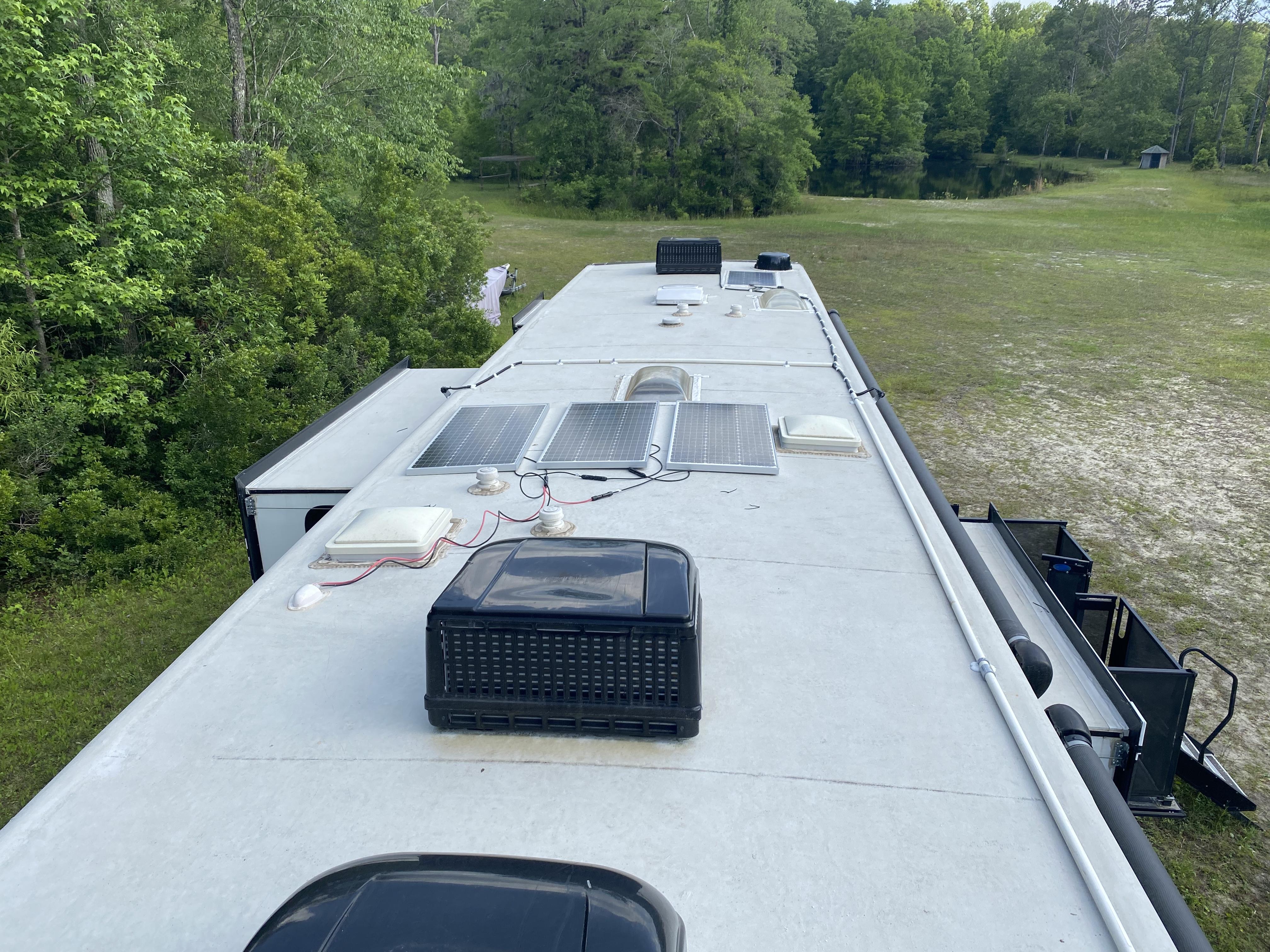

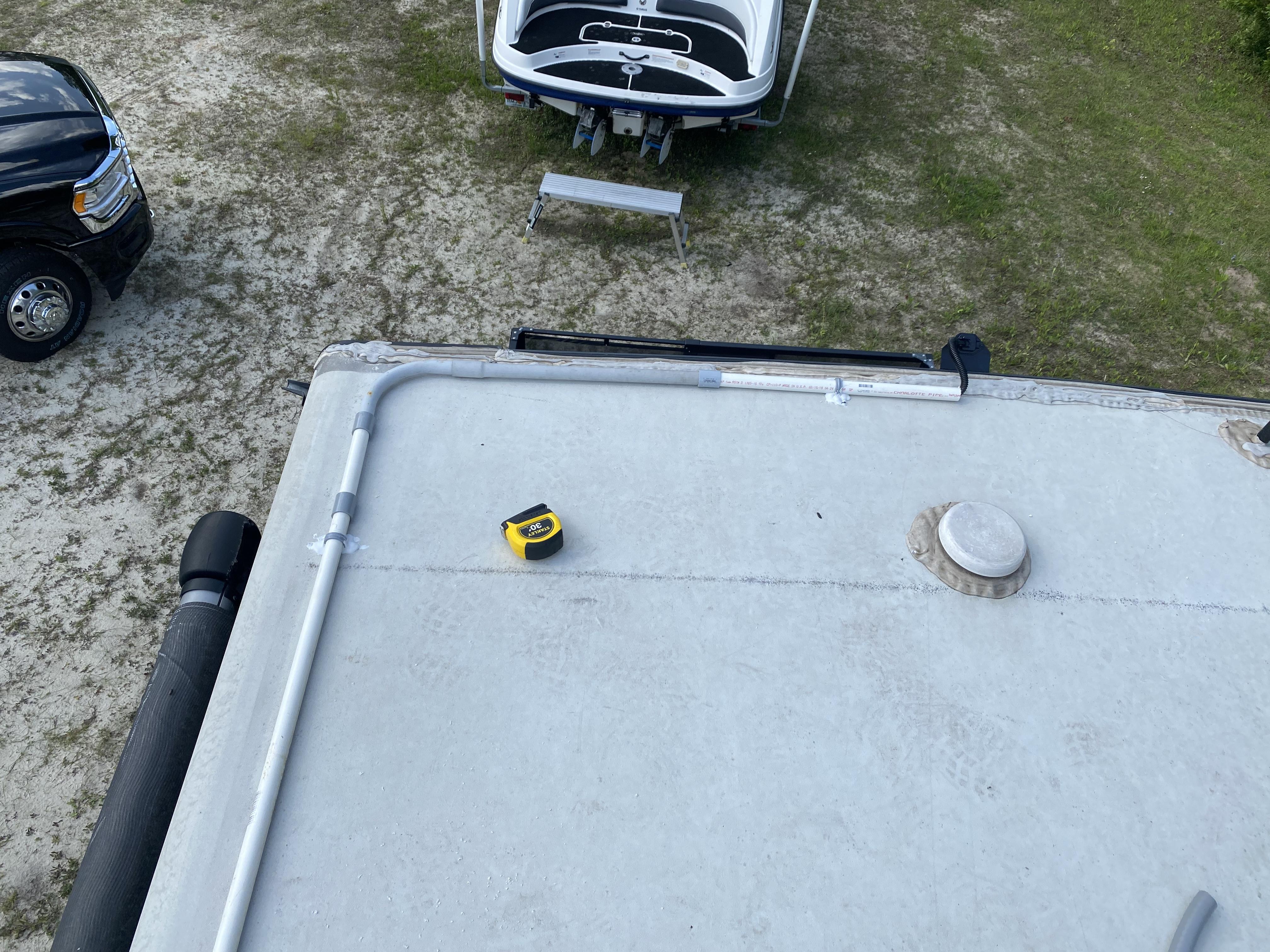

Thanks for the great tips on routing the tow mode camera for a 5th wheel! I'm waiting on my truck to arrive (ordered 11/12, should be here in the next week or so according to dealer) and wanting to plan for cable run on my 41'4" Alliance Paradigm 385FL (it should be ready for pickup in 3 weeks). How long is the cord that comes with the tow mode camera from Ram? I'm thinking of running the cable down the ladder from the rear and then along the underbelly in PVC or flexible cable shroud to the front pin box. Trying to keep from running along the roof if possible but may end up going that way also after I get them home. Thanks for everyone's help!

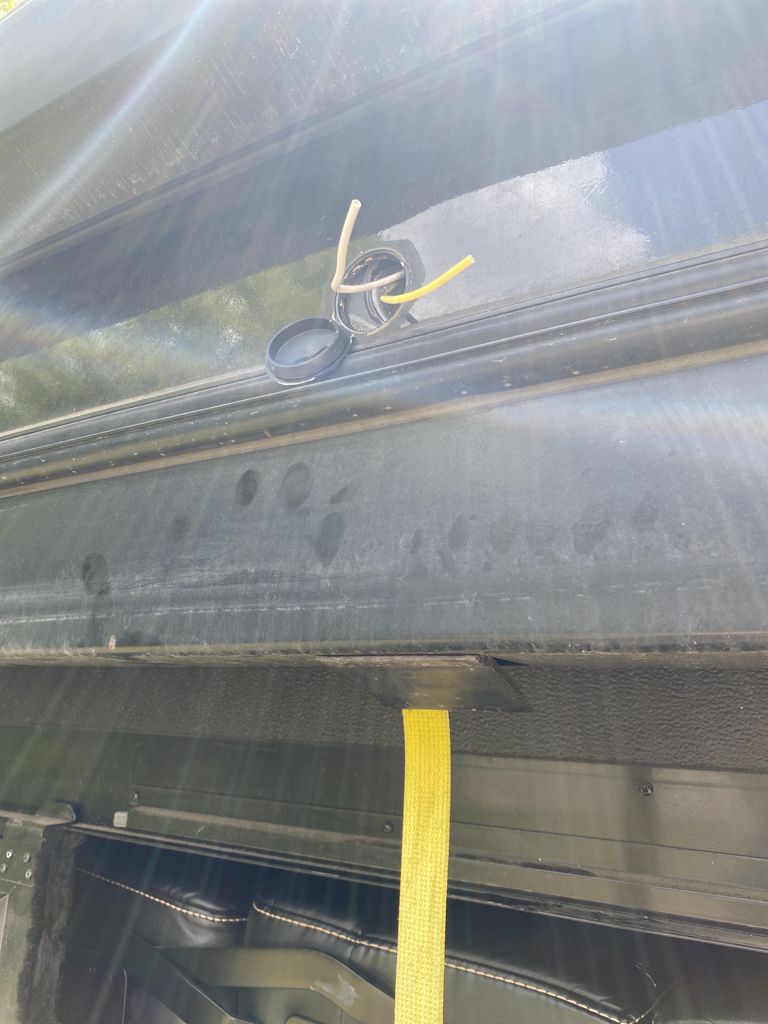

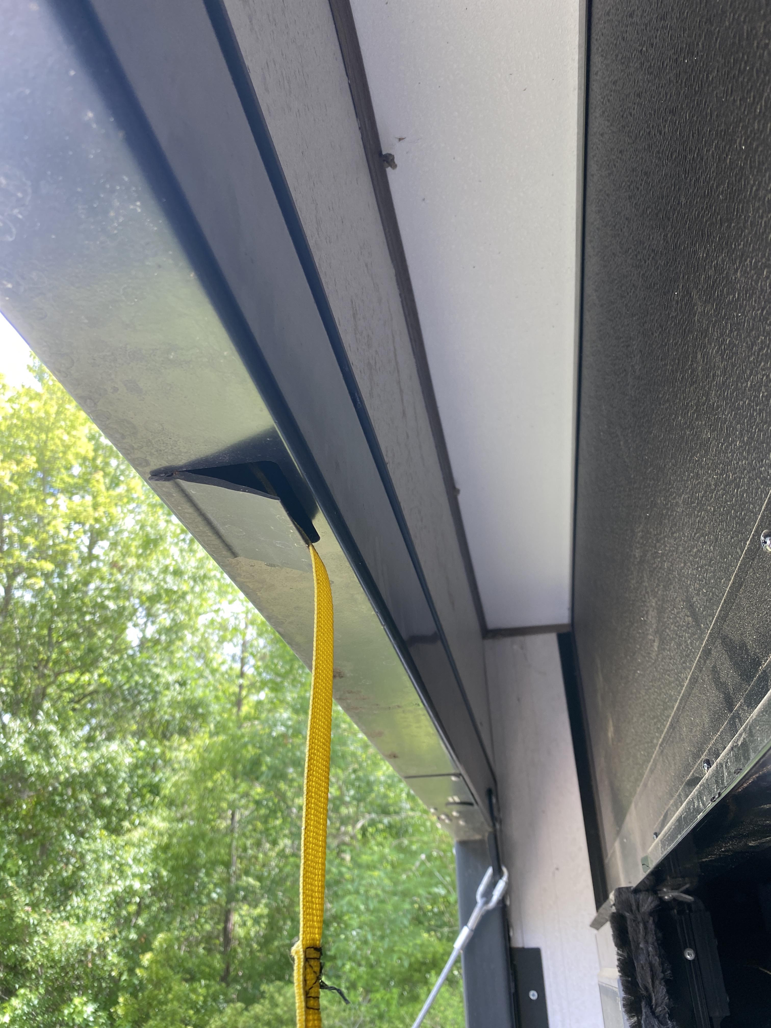

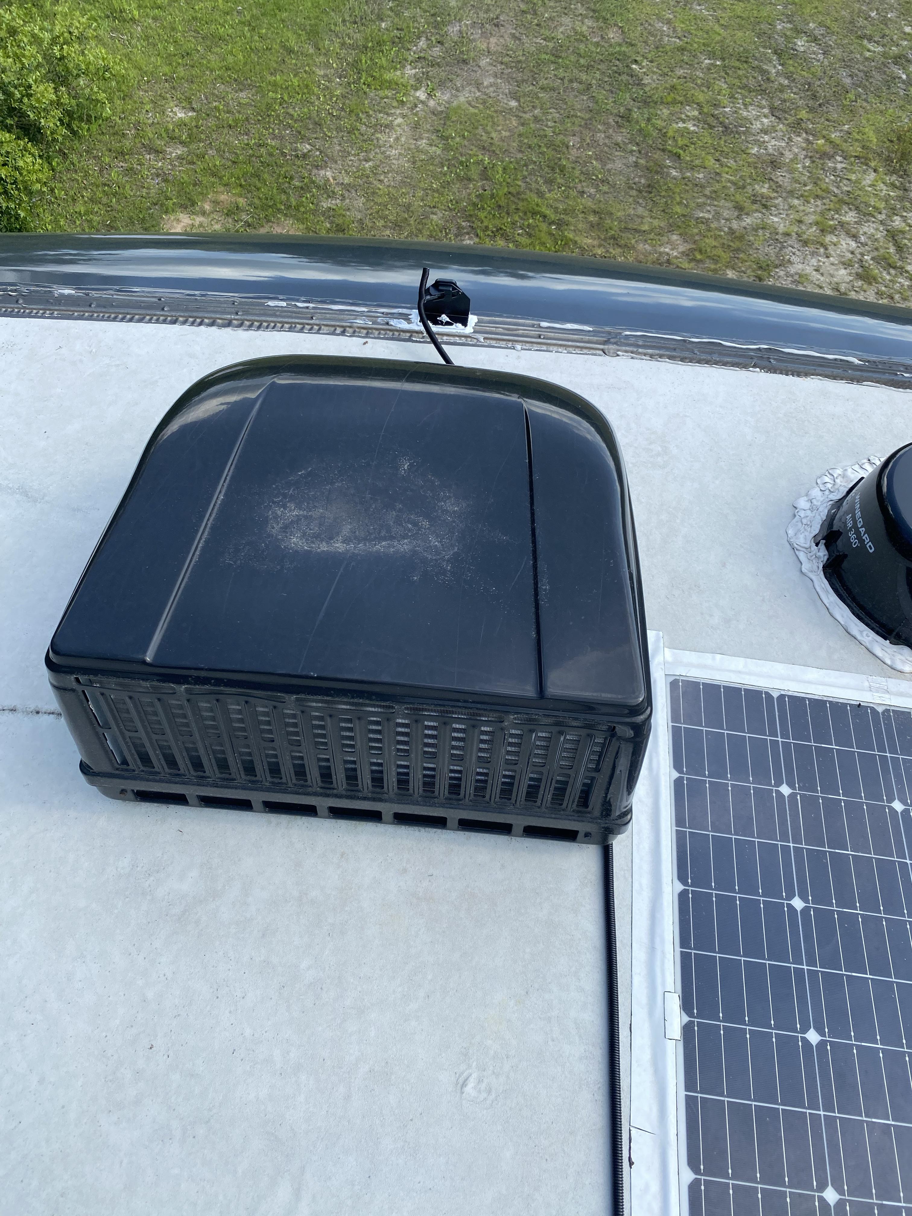

I had thought about running it up top, but currently looking at going from a high center mount down the side of the rear ramp and up the underbelly on the left side. Another option is to follow the 360° camera hole I have on top, but I don’t have the time to move the mount from the bumper to the bed.

I just received my camera and will be installing soon. Is putting it ~ 11 feet from the ground higher than ideal? I could put it lower but debating based on the unclear instructions.
Can anyone comment if a high mount like that worked well or if lower is better?

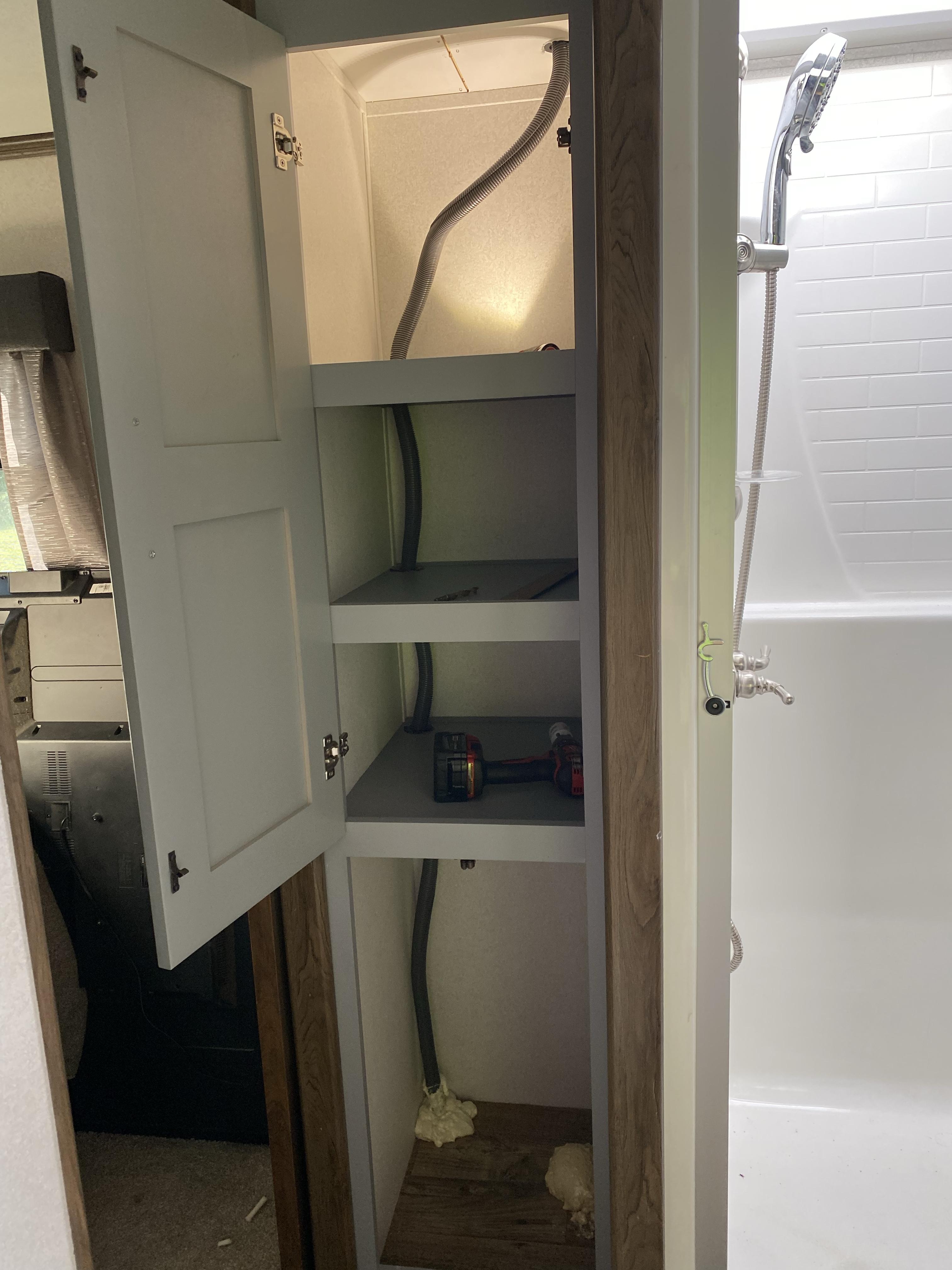

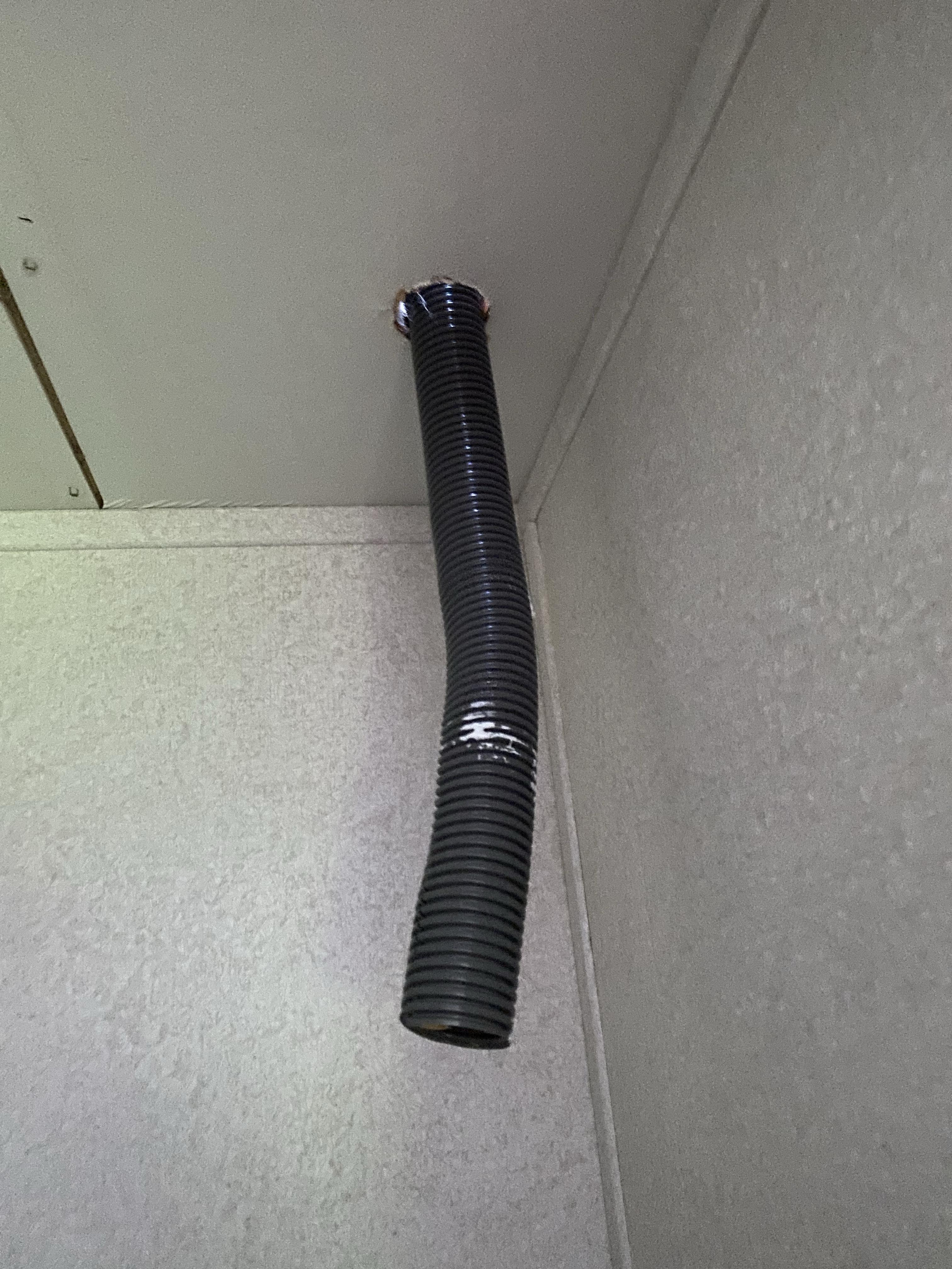

On my last trailer I was able to snake up through the trailer lights and wiring. Simply not possible on the new one so I ran along the ladder and then through the belly
