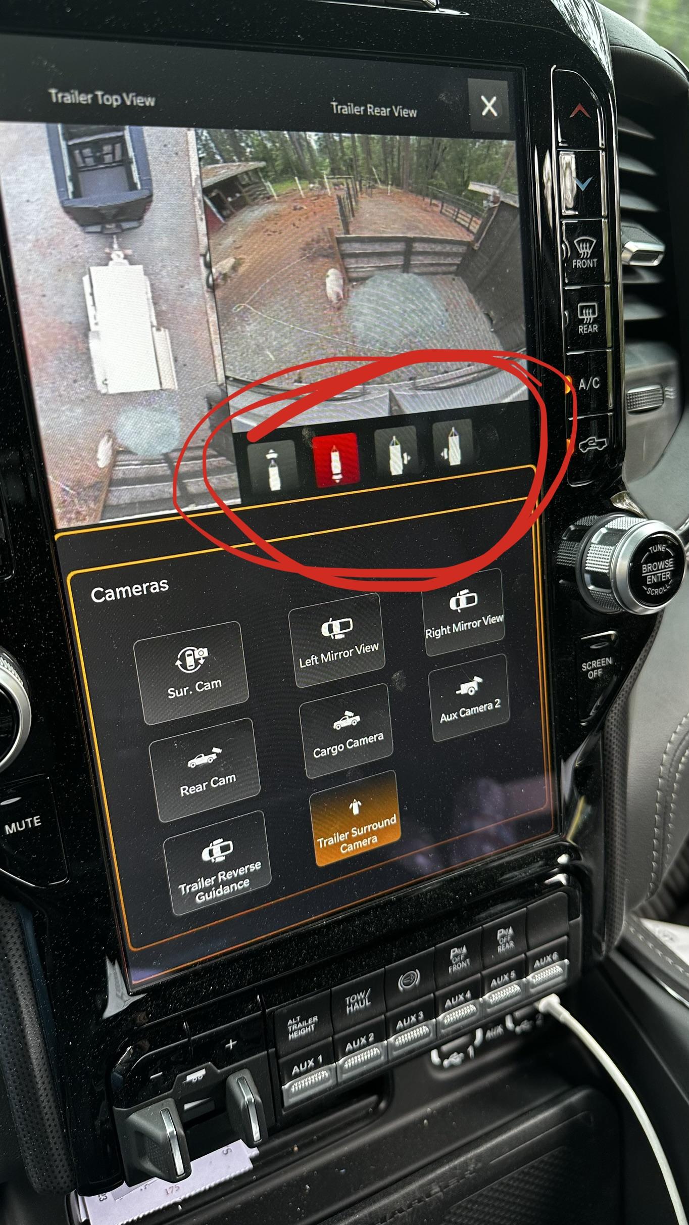

I finally got my trailer surround cameras installed and noticed that the view buttons under the video feed do not work. I have a video of it but here’s a pic to start, I circled the buttons I’m talking about. These buttons are functional on the truck 360 surround but when in the trailer view they do not allow me to select different views.
I have a ‘22 3500 with MY22.S26.17-PROD. Looking to see if someone else with the trailer surround can verify if these buttons work for them or not.
I also have NAVIKS installed but did not have the trailer setup in place before I installed that to know if it worked before. When I talked with them they said it is likely not working from the factory or something is not enabled on my truck. Trying to see if I can confirm without removing it first.

I can verify that all of those buttons do work on mine.
I would definitely remove the naviks, reboot the radio two times, and then check.
Thanks. I guess I’ll check.
Do you have NAVIKs as well to say if it works with it installed and that maybe after I reboot I can reinstall it and it would work?
No, I don’t have naviks
Confirmed that with the NAVIKS removed the buttons work again. If there is anyone in the Northeastern US that has the trailer 360 installed they may need someone to test with. I’ve sent them the video and they are going to take a peek.
