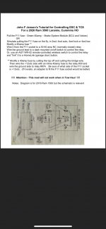

Yes you need LSD friction modifier. The traction control button turns off the traction control only untill your wheel speed hits a certain limit to turn it all off you have to pull a fuse build a relay setup to switch off the system
@John Jensen this is his setup he used

I don't think the nannies are ever really off in stock form. I installed a relay and switch so I can really turn it all off.
