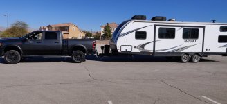

I have a 30 TT. I use a WDH and airbags with 0 issues. Moved cross country with it loaded, probably 1000 lb tongue weight and another 1000 in the bed. Overweight, but airbags at 60 lbs and everything was fine.

I have a 33' Bullet 287qbs that weighs in at about 6000lbs dry with about 750lbs tongue weight. I also have a Moomba boat that weight in at 4200lbs dry . For the camper i have a weight distribution hitch and if set up right it pulls it effortlessly. This truck can tow very well.
