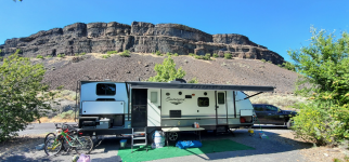

Trailer:
Location: Dry Falls / Sun Lakes, Coulee City, WA
