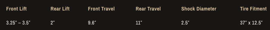

Lift Kit:
CJC OffRoad 3.25 Pintop for Factory Air Ride
From CJC OffRoad:

Lift Kit:
From CJC OffRoad:
