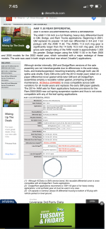

Where do I find the axle ratings? I believe this has the same axles as the dually and the only difference is the extra tires.
GAWR for my 2020 RAM 3500 is 9750. Not the same as the SRW trucks. The 2019 and 2020 SRW 3500 only added 1500 pounds of payload over my 2013 RAM 2500. So I knew I needed a DRW so I am not truck limited when buying my next toyhauler.
