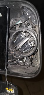

Hello all,
I have a 2022 Ram 2500 that has the tow mirrors and one of the mirror motor/actuator is broken. I can't find the part number or replacement part any where. I've attached a pic of the motor. Is there a way to order this part? I've seen the 2023-25 ones for sale but not the 2022. Is there an after market option? Thanks.

Yes, I found one on eBay. They are sometimes listed as either right or left and was the larger mirror instead of the smaller one. All you have to do is look at the picture of the item and ensure it looks just like yours. Right or left doesn't matter. I bought one that was supposedly for the other side but they are interchangable. How the are mounted determines how they operate. Here is a link to one that should work, but verify it looks identical to the one you need. https://ebay.us/m/DILwvR
Also, don't worry about the year. The key thing to look at is the actuator bar in the middle. The newer models have a more pointed/tapered edges where the one I needed has more rounded edges. That is the key area to look at when buying.
Any idea of they come with the teethed white prongs that actually make the mirror move? Those are broken on mine.
Not sure how much it will help since it looks like you broke the little gyro thing, but I was able to replace the motor with one from eBay from another car (it’s not made by ram and it’s relatively common) when I broke it replacing the convex mirror

Yeah they're broken, let me look into it and see if i can find one similar that comes complete. Thanks!!
Not sure if anyone will see this since this is an older thread, but I need the same exact thing. I did an "uh-oh" and hit the side of my garage entry and it popped the lower side glass out (and broke). I got a new side glass and then realized that it was the actual cup mount (or whatever it's called, that broke. I can't find the parts anywhere and it's looking like an expensive WHOOPS. Any help in locating one would be appreciated as I'm not so good at this sort of thing. 1000008975.jpg1000008976.jpg
Not sure if anyone will see this since this is an older thread, but I need the same exact thing. I did an "uh-oh" and hit the side of my garage entry and it popped the lower side glass out (and broke). I got a new side glass and then realized that it was the actual cup mount (or whatever it's called, that broke. I can't find the parts anywhere and it's looking like an expensive WHOOPS. Any help in locating one would be appreciated as I'm not so good at this sort of thing. View attachment 89721View attachment 89722
Any luck with the links above? I found mine on ebay.. $45 for the whole motor (oem).. if I can find one soon I'll post link.
Thank you, at this point all I have been able to find is the entire mirror assembly. I'll keep looking. I appreciate the response.
