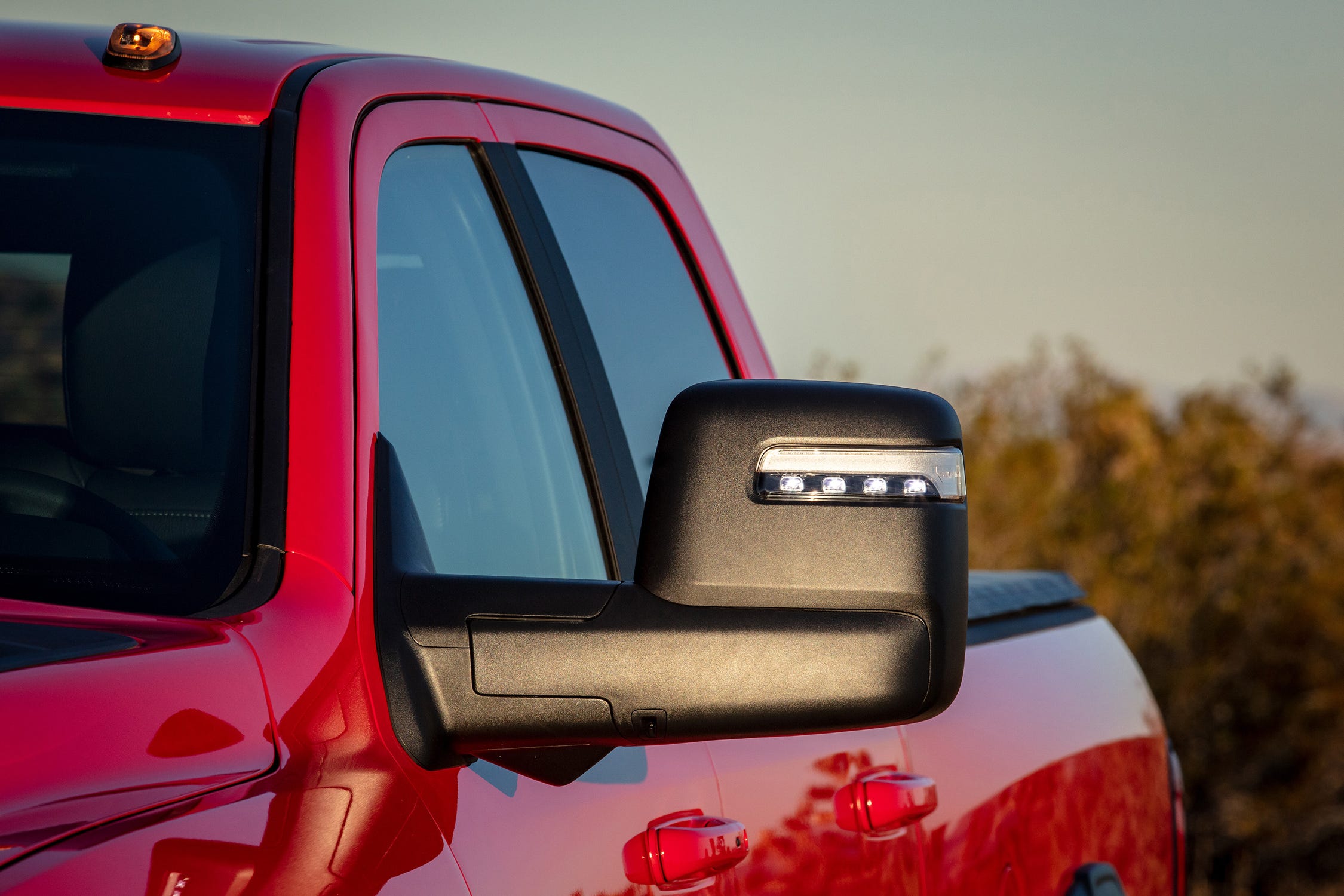

Does anyone know what adaption or module to select on JScan to enable the mirror Spotlight while in motion or do I need alphaOBD to make changes? I live in California and unfortunately can’t have the spotlight on while backing up. Sorry if I missed a post in regards to the question I’m asking but couldn’t find any info.
Modules > body computer > configuration >
Which lights are you talking about?
The front utility lights on 23+ towing mirrors. They shut off as soon as the truck starts moving.

How bright are they will the illuminate the side like ditch lights?
I have a 2020 so nothing like that on it.
Cool
Definitely not quite as bright as a good set of ditch lights, but they’d be useful for slow moving while off-road, or maneuvering around a forest camp spot at night.
